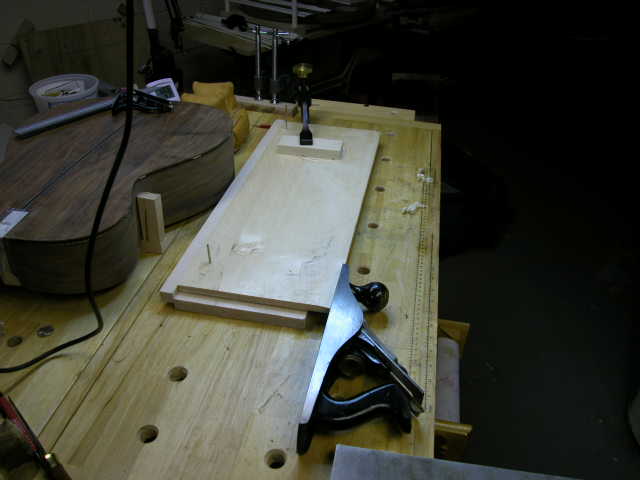

That's a nice looking shooting board, Frank. Here's a pic of one I built when I first started building guitars:
The spacer was originally one piece, but I cut it up because it was too wide for some of the tonewood I have. I used a block plane with it and was often frustrated at the number of times I'd have to shoot the boards before I got a nice tight joint. Later I tried using a jack plane, and finally a #6 Stanley. At that point I thought, "Why bother with the board?"
So I don't use it anymore. I use this now, and it works much better:
I just grab a flat piece of wood for a spacer -- a piece of oak is shown -- and clamp the plane down to my sanding board. The sandpaper keeps the spacer from moving. Um, Michael, you do have a sanding board, don't you? I use mine all the time.

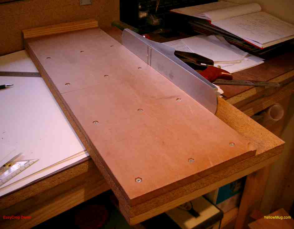

A piece of 19mm MDF (or chipboard) as the base. Glue and screw a piece of 19mm MDF
on top leaving it about 75mm short of the edge of bottom sheet on one
side. Screw a piece of 25 x 19mm batten across one end of the upper
sheet as a stop for the top and another underneath at opposite end of
board to hook over edge of bench......hey presto one shooting board.
If you want plans...see Jim Williams' book on guitar building. he uses
plywood but MDF does the job.

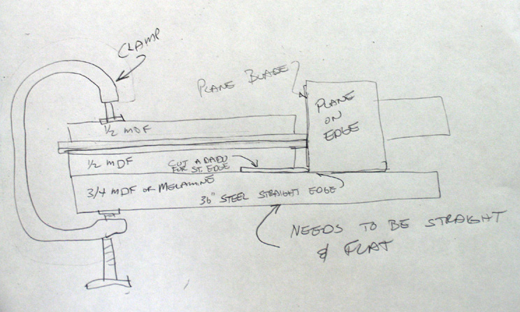

Here is a crude sketch of mine. It works pretty good, mainly because the plane is guided by the straight edge, not the skill of the operator.
I started out using a setup like Jon's, just clamp the top or backs between two pieces of word and go for it. It didn't work very well for me. I think my plane is to small and my skill is to little....

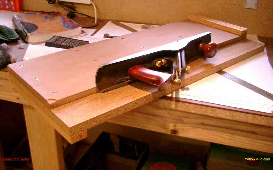

Again-for great shooting board plans by a proven master-go to Lie-Nielsen-choose block planes-choose the miter plane-click on link to David Charlesworth shooting board. Here is another pic of mineMT
